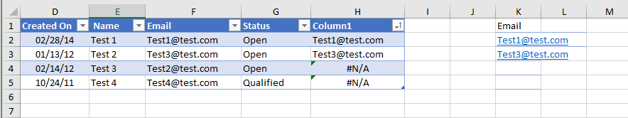

- Your Advanced Find should have the Full Name, Email Address and Status Fields as Columns.
- Run the Query and Export the result to an Excel Worksheet.
- At least 3 blank Columns to the Right of the Table, copy your email addresses that you wish to Disqualify
- It should be sorted by Email Address
- Create a Range Name for your copied Table
- I use one Letter like "L" for Leads
- In the Column to the right of your Table, add the following Formula
- =VLOOKUP([@Email],L,1,FALSE)
- False is very Important so it will result in "#N/A" if it is not found
- The new Column will be called "Column1"
- Sort by "Column1" and all of the tagged Emails will rise to the top
- Hopefully it will match the Rows from you copied Table (L)
- Delete the full rows of all the Leads that end with "#N/A"
- Change the Status for all remaining rows to "Disqualified"
- Save the Worksheet with some meaningful name like "Disqualify Leads (###)"
- I like to put the number of Rows I am affetcing in the name as a Proof of the change
- Import the saved Table back into CRM
- When the Import is complete, all of your Leads will be updated as "Disqualified/Deactivated"
