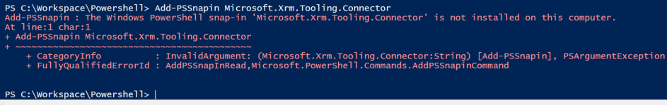

    Then, we ran "Add-PSSnapin Microsoft.Xrm.Tooling.Connector" command to add Xrm connector powershell snapin. And we got the following error:
    Could you help us to resolve this issue?

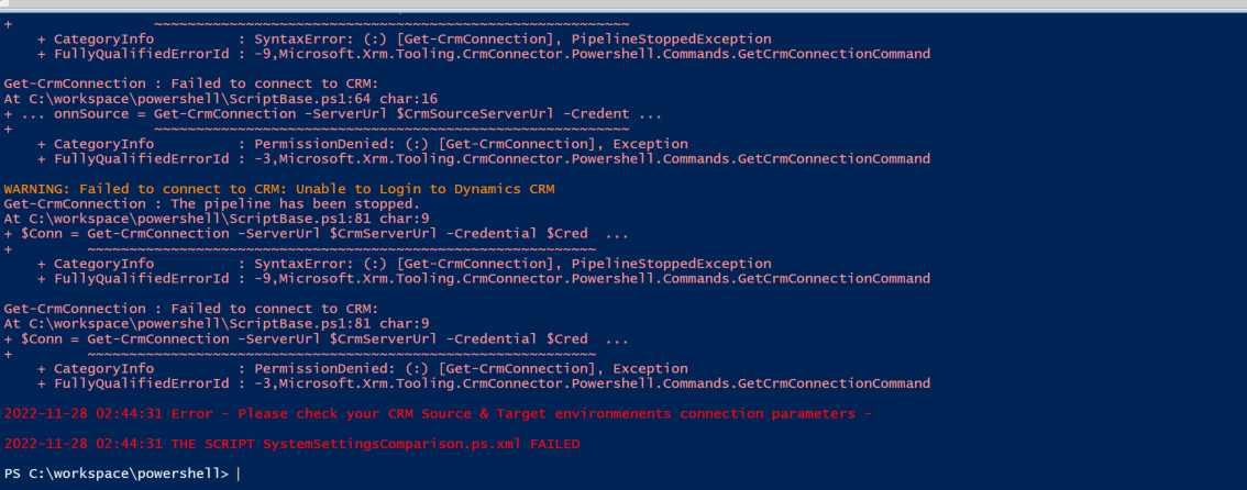

    Also, we  are getting the following errors too:
    Note that we were able to connect to V9.0 organizations.

    try reinstalling the Package that you've already installed (uninstall and install again please store as backup all the information that you can  )
    Please run PowerShell as Administrator
    https://stackoverflow.com/questions/47297832/add-pssnapin-microsoft-crm-powershell-not-installed-error
    https://learn.microsoft.com/en-us/previous-versions/dynamicscrm-2016/developers-guide/dn689040(v=crm.8)?redirectedfrom=MSDN
    the reason could be that after you installed the new version of dynamics you overwrote some key setting
    I think that we are talking about dynamics on-premise version
    I hope it helps and good luck

    We already resolved the issue related to the command "Add-PSSnapin Microsoft.Xrm.Tooling.Connector".
     But We are still facing the connection issue.
    In your reply, you recommended us to reinstall the Package that we have already installed. What package you are talking about? Is it Dynamics 365 V9.1?
