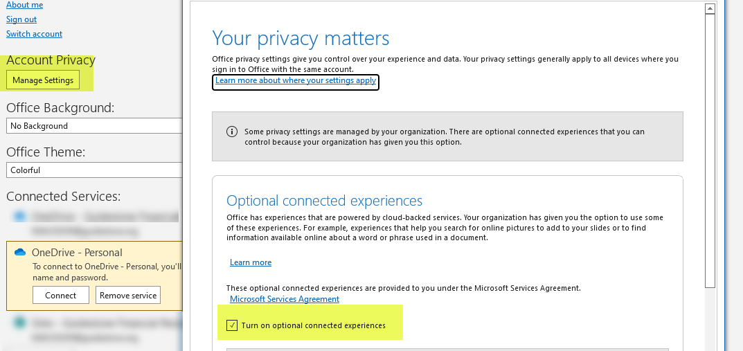

    Check the Optional Connected Experiences setting in Outlook for the user:
    File | Office Account | Account Privacy | Manage Settings
    Enable the 'Turn on optional connected experiences'

    Thanks for jumping in!  Those settings are set as recommended. One thing to note: On by my computer and on the computer of the other user, this was all working like a charm up until about 2 weeks ago. Then nada. Also, emails to and from contacts that were previously set up to be tracked are still showing as being tracked in Dynamics 365.
