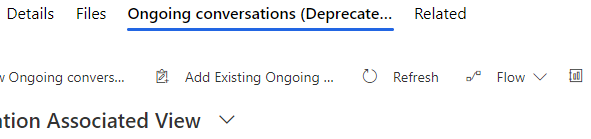

    Tab Headings truncate in Wave 1 -  and they still do in Wave 2
    This is from Wave 1   (it is only a sample picking the longest related entity (not used but it is there0
    Appears the same in Wave 2 -  so no change -  Tb Headings on form and on sub-grid
    As a suggestion -  remove the Section x: from your tab headings - totally superfluous in my opinion.
    As for your picklists -I'm pretty sure they also truncate -  depends on column size -  ie combo of screen resolution and number of columns across the page.
    Labels will wrap (as your addresses do - once again I remove the "address1: bit and put them in a section with a header - much cleaner
    And as for the deploy timeframe - various across regions  - that's when they start pushing automatically. If you want it sooner you have to manually activate it as Neils has said
