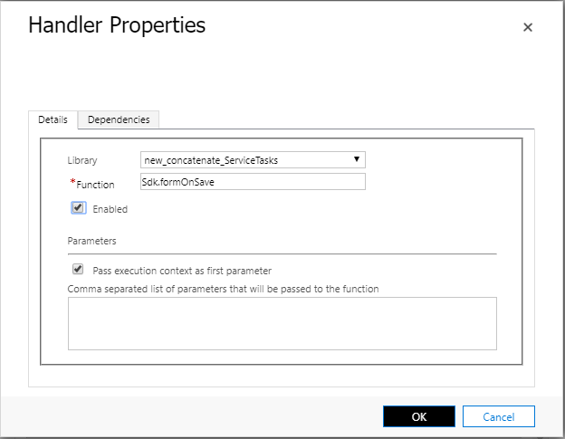

    I've passed the execution context as the first parameter:
    I've published all customizations lots of times and, tried a different browser.  The most bemusing thing is that the script works, I just get a popup script error!
