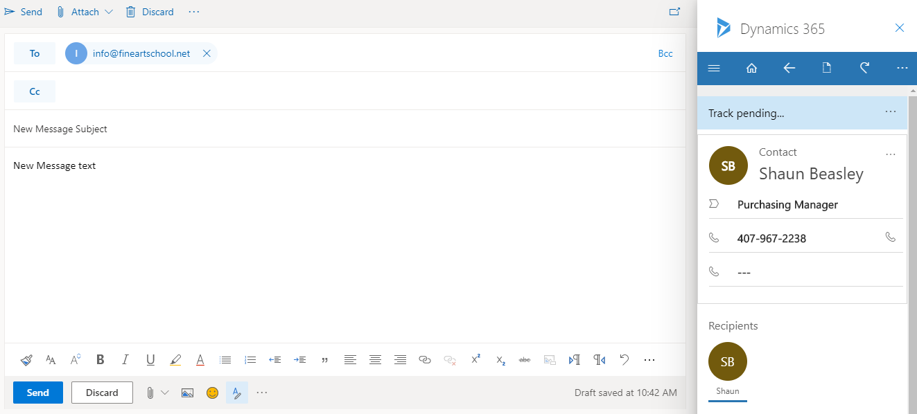

    @Rosemarie Cordell - If you are using the D365 App for Outlook within Outlook, the users would send emails from Outlook like normal. The only extra steps would be to select the record to track the email against.

    Hi @Rosemarie Cordell, ​I'd suggest the following permissions although not necessarily at the levels in my screenshot.  The permissions would need to be consistent which your existing security structure.
    Let me know if you require any further details.
