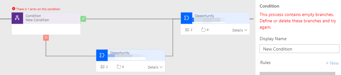

    Has anyone come across this before? I have a BPF with a Condition that checks a field in a prior stage. I have a stage set in the "Yes" branch and in the "No" branch. However, I am getting an error message that "This process contains empty branches".
    Any thoughts?

    Did you ever figure out how to resolve this? I am seeing the same thing and even when I deleted and reenter my Condition step it gives me the same "contains empty branches" error.
    Mike

    I believe your issue is you need to have the same number of stages along each path.  So, in your example, if you add another stage between the Yes Condition and where the branch re-attaches, so both paths have the same number of stages, then this will address the error.
