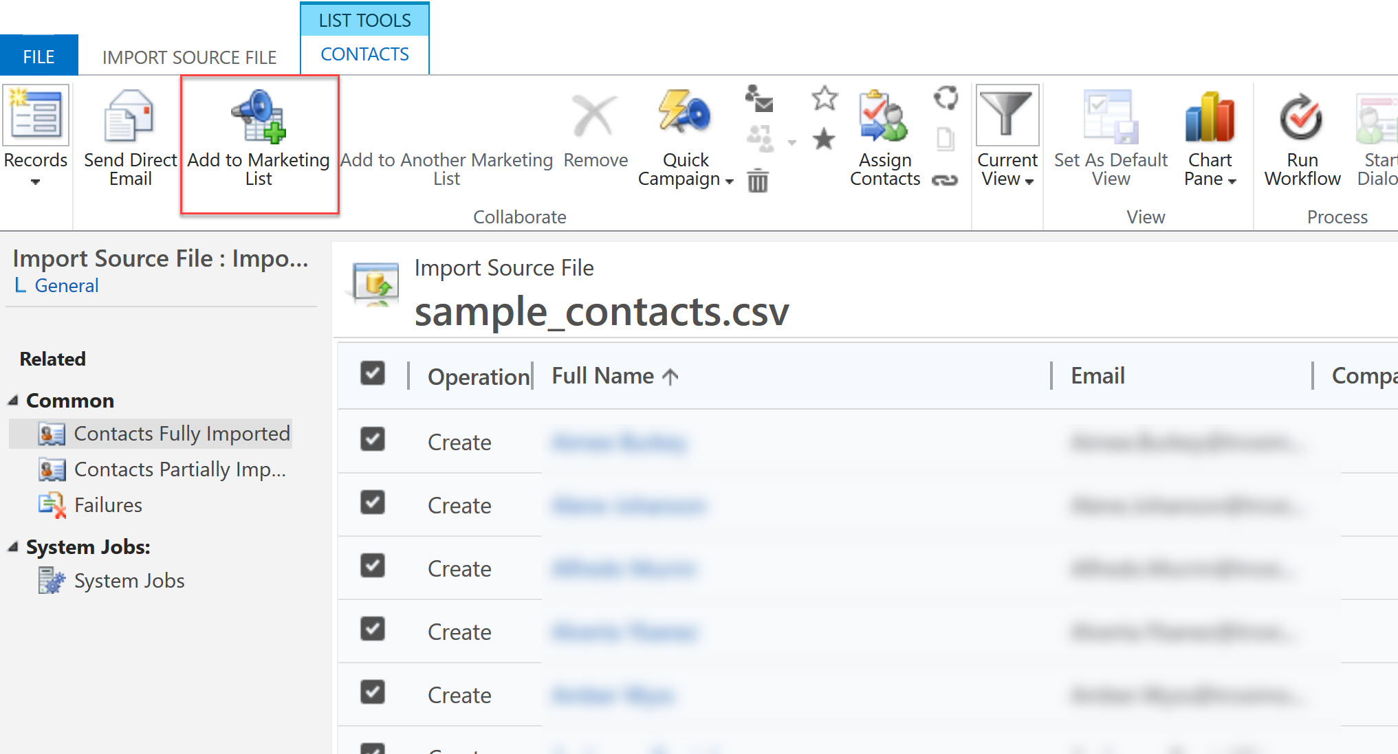

    Actually you do not need to do an Advanced Find if you use the native import functionality in Dynamics. Just open the Import job (Settings >Data Management > Imports) and view the imported Contacts in the related "Fully Imported Contacts" list. Select them, and you can add them to a marketing list with the button:
    The limitation with the native import feature though is that when you are importing you have the option to import all the contacts and ignore any duplicate detection rules, or to prevent duplicates.
    If you choose the first option, you can end up with a bunch of duplicate data in your Dynamics instance, and the original Contacts that were already in Dynamics are not easy to find if you want them on a marketing list. If you choose the second option your import job may not have all the Contacts on it that you had in the Excel file you started with, and you would have to manually go find the ones that already exist and add them to a list. This is the primary scenario that caused us to create the Import Tool feature in ClickDimensions, so that you do not end up with duplicates and you do not have to go find the contacts that already exist in Dynamics.

    You learn something new every day!  I had no idea about the import to marketing list feature.  That's great.
