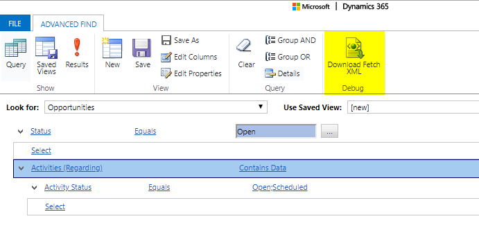

    @Niels Søgaard Lønberg - I usually use the Advanced Find window to help me get started with the FetchXML, especially when ​joins are involved.
    Within the Advanced Find window, there is a "Download FetchXML" button. And, as you can see, I have Opportunities and Activities "joined" using the "link-entity".
    <fetch version="1.0" output-format="xml-platform" mapping="logical" distinct="true">
    <entity name="opportunity">
    <attribute name="name" />
    <attribute name="customerid" />
    <attribute name="estimatedvalue" />
    <attribute name="statuscode" />
    <attribute name="opportunityid" />
    <order attribute="name" descending="false" />
    <filter type="and">
    <condition attribute="statecode" operator="eq" value="0" />
    </filter>
    <link-entity name="activitypointer" from="regardingobjectid" to="opportunityid" link-type="inner" alias="ab">
    <filter type="and">
    <condition attribute="statecode" operator="in">
    <value>0</value>
    <value>3</value>
    </condition>
    </filter>
    </link-entity>
    </entity>
    </fetch>
