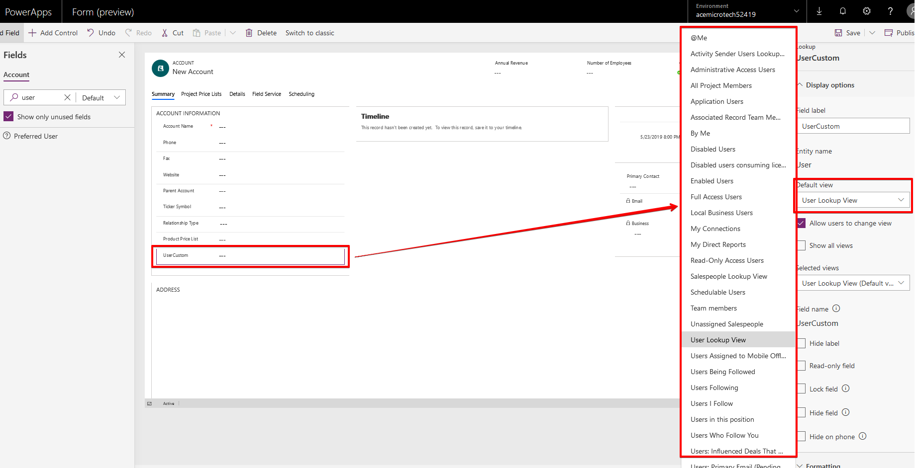

    @Niels Lønberg - You should be able to create a custom View to include all the Users no matter the Access Mode. Then you can change the "Default View" for the custom user lookup. Below is an example using the new Form editor.

    However, ​what I'm trying to achieve is actually a step earlier - it's not related to the lookup view itself. Right now, only users with a license are showing up in Dynamics 365 - which also kind of makes sense. However, I would like to include users that don't have a license.
    So the question is - how do I get them into Dynamics 365 in the first place if they don't have a licence? Do I need to use a security group, where I include all users?
    And another question - if the users don't have a license - can I still select them from lookups (not as owner)?
