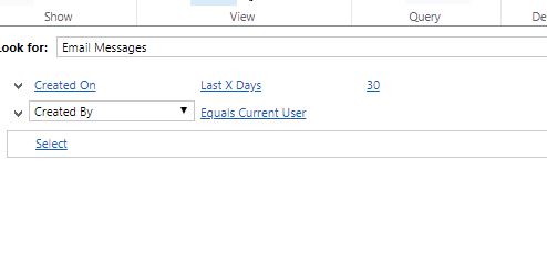

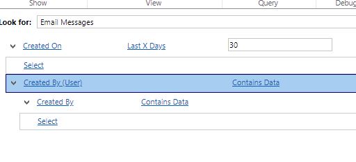

    2. Create a view for the entity in question, using one of the options below(you will need to test which works best). Remove all but one columns from the view.
    3. Create a workflow which is triggered on create of custom entity you are interested in
    4. First step, Kaskela Workflow element>Query -Get results.
    5. Pass in the query you created in step 2 (either as a query or fetxh xml)
    6. Add check condition, is GetResults #records > 30?
      • If true create your email
      • Else stop
