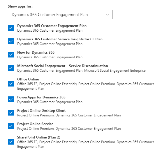

    @Anthony Parks - Something to check in your Office 365 Admin Center when assigning licenses: When assigning licenses, many of the license options have an expandable group to turn on/off many of the included apps under the subscription plan. For example, the Dynamics 365 Customer Engagement license has many apps included:

    It seems that if the Microsoft Flow Free license is assigned, new user records are created in Dynamics 365, but without a Security Role. I can see the confusion and concern.
