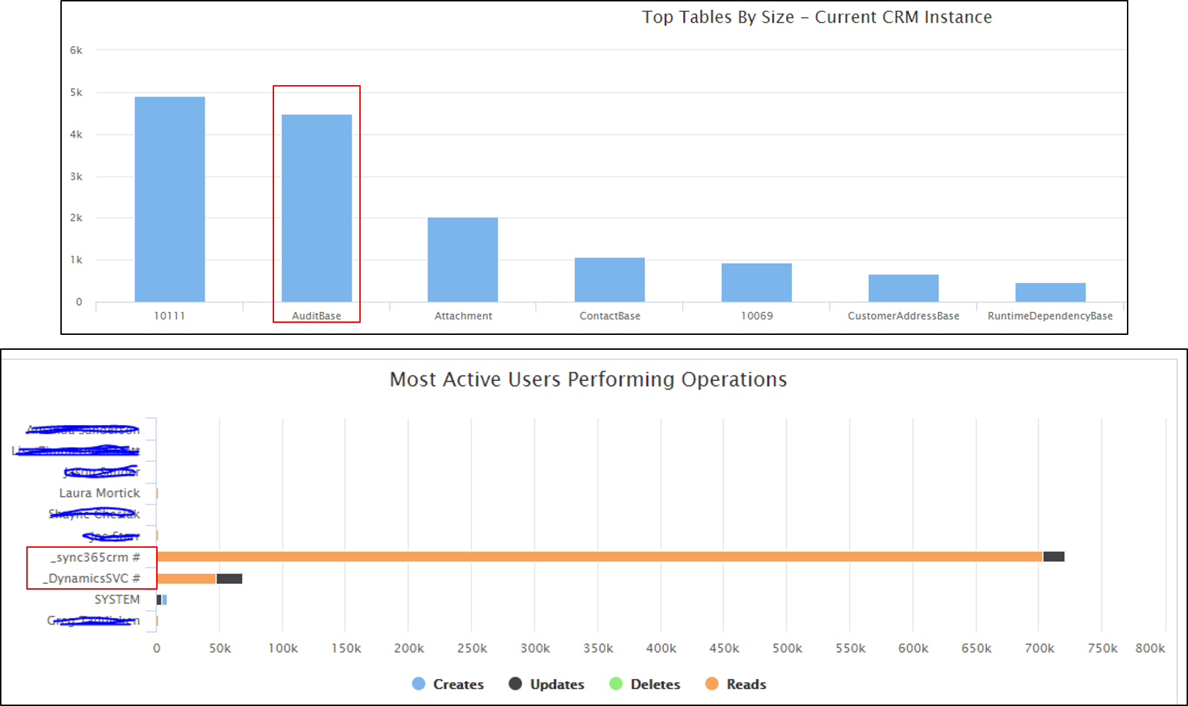

I like the new Admin dashboards available, just wish they could be customized a bit. We are using this dashboard to monitor our storage usage and notice that the largest table is our AuditBase table. We were planning to delete a lot of these audit records, but wanted to check on something first. This dashboard also provides information about active users who read or create records in the system over a certain time period. Is this calculated using the audit records? In other words, if i delete all the audit records, will i lose my visibility into the active users?
Also, we have a system user (two actually) that we use to sync records via KingswaySoft. Is there a way to exclude this type of users, so the charts are a bit more meaningful? This really skews the chart and I cant see any of the data regarding our real users, because their usage is so small compared to the sync system user. (see bottom screen shot)
