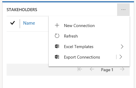

    ​I just checked in our v9 development instance and it appears to be working ok.  Is it possible someone customized the subgrid for Stakeholders on your Opportunity form?  If so, have you tried adding back the out-of-the-box subgrid to see if that resolves the issue?

    I notice the grid you're using isn't the one Ben showed. What entity is this on, and what connections are you trying to create? The grid on the opportunity form that Ben showed is the "Stakeholders" grid on the Opportunity form. This uses one of those "special" views that can't be amended, and actually contains some hidden functionality. In this case, is creates a connection with the "Stakeholder" connection role. I can't see any way to change this behaviour, although you can amend it later.
    It's possible that creating connections from certain views isn't supported yet. I tried creating another subgrid of connections on the opportunity form, and this displays very differently in the Sales Hub:
    This did allow me to create connections, but directed to the full connections form, prompting me to select a connection role. I guess the grid you're looking at must be different again.
