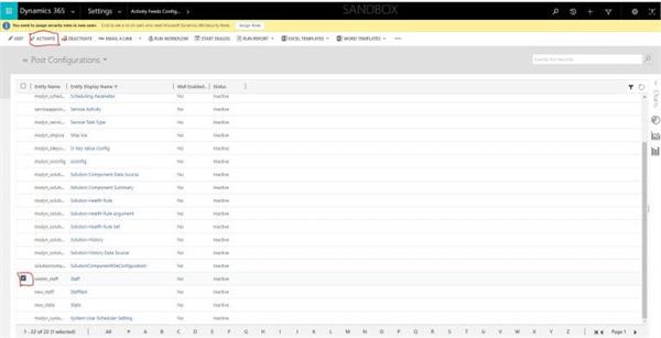

  • Look for the custom entity, in my case, I’m looking for “Staff”. If it isn’t visible, then click on the “refresh” button (highlighted in red circle). Right now, you can see the “Staff” entity in the list below which is circled in red and the status of this entity is “Inactive” (highlighted in Yellow).
Setting Up The “Follow” Functionality In Microsoft Dynamics CRM - AhaApps
  • The Status shown in the above image needs to show “Active” in order to set the functionality to follow a record from a custom entity. So, select the entity and click Activate.
