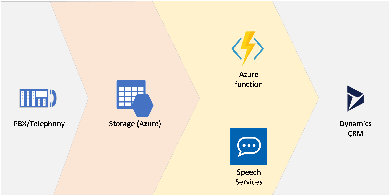

We will use the following components:
  1. Azure Blob to receive recorded audio files from telephony system.
  2. Azure cognitive services to listen to recorded audio files and translate the content to a text message. The audio file will be saved in  Azure blob (which is cheaper than CRM database storage).
  3. Azure function (with Azure Blob Binding) to recognize the text from the audio file and extracts the case description.
  4. Dynamics 365 Web API to create a case in CRM using the description extracted from Azure Cognitive services.  We can also add blob metadata like filename, etc. to case properties.
