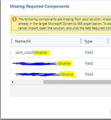

    I'm getting the error message below when I'm trying to export a solution - which most of us have probably seen before.
    The following components are missing from your solution. Import will fail if these components don't exist already in the target Microsoft Dynamics 365 organization. To add the missing components to your solution, cancel import, open the solution, and click the Add Required Components button.
    However, all of the missing required components are name fields related to lookups.

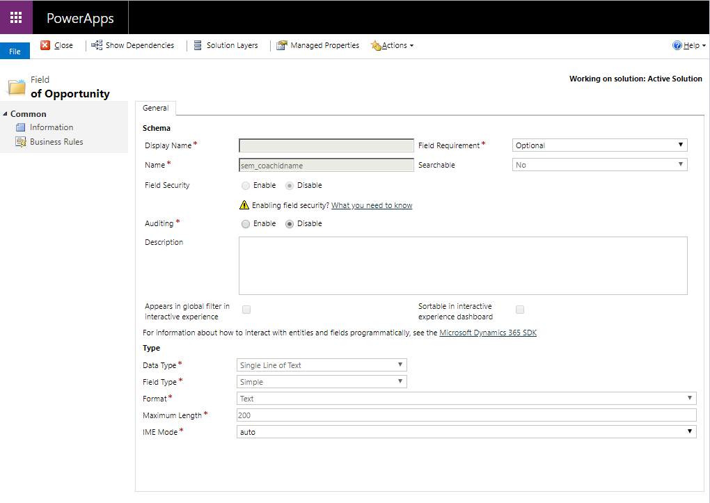

    E.g. one of the fields missing is the sem_coachidname field below. The lookup field itself and the relationship are already included in the solution. Is there anywhere I can add these name fields individually - or is this a bug?
