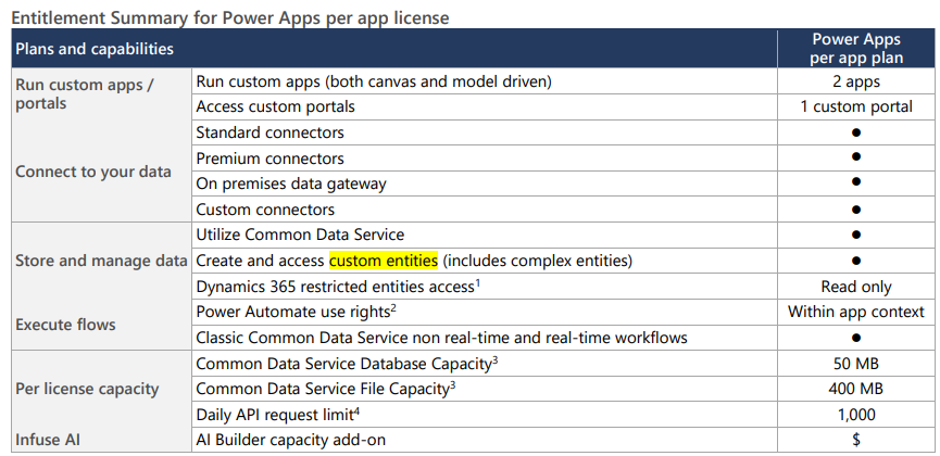

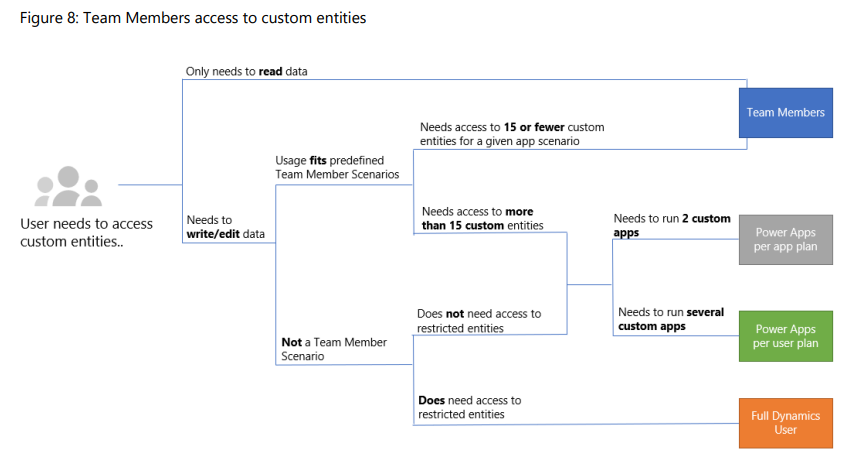

    For a full understanding, review the Power App and Dynamics 365 licensing guides. Here's some relevant screenshots, though. The flow chart in the second is really helpful, and it's even what Microsoft says on this matter.

    Entitlement Summa
Plans and capabilities
Run custom apps /
portals
Connect to your data
for Power A
s era
license
Run custom apps (both canvas and model driven)
Access custom portals
Standard connectors
Premium connectors
On premises data gateway
Custom connectors
Utilize Common Data Service
Store and manage data Create and access custom entities (includes complex entities)
Execute flows
Per license capacity
Infuse Al
Dynamics 365 restricted entities accessi
Power Automate use rights2
Classic Common Data Service non real-time and real-time workflows
Common Data Service Database Capacityg
Common Data Service File Capacityg
Daily API request limita
Al Builder capacity add-on
Power Apps
per app plan
2 apps
1 custom portal
Read only
Within app context
50 MB
400 MB
1,000 UserneedStO
Figure Team Members e55 to : t03 entities
