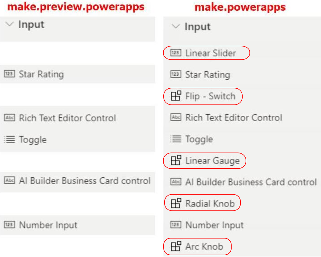

    I started using the Make.Preview.Powerapps.Com portal recently, and really like the new treeview method of navigating solution elements...
    One thing I noticed about a week ago is that some of the newer input controls were only appearing in the Make.Powerapps.Com portal, and not the Preview portal.  I would have thought the Preview portal would have everything the old portal has, and more...
    Now, I see that these 5 input controls no longer appear at all in BOTH portals!  I have used the "Flip - Switch" control several times on a Main form, and these still function correctly, but I cannot add another one.
    Has anyone else noticed this, and have any idea what happened to these controls??

    Well, I guess I found the answer to my own question:
    New Model Driven Apps controls, deprecation of old controls | Microsoft Power Apps

    It's quite weird that they have only lined on a replacement for the flip switch.
    However, you can find (even greater) alternatives on pcf.gallery made by community members. As an example @Tanguy Touzard just released the ​Linear slider with steps control.

    Thank you Niels, I installed that exact package and I am now using the "Custom Switch" control which works great.  I can specify colors, round or square style, and it also doesn't turn grey when you use it for a Read-Only field.
