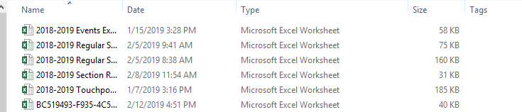

    I have 1 user who has brought to my attention the fact that when she does an excel export using Chrome it exports it in a non-excel format (see the 'Type' from the screenshots). It looks like it's an excel file, but excel says that it's corrupt. I've included two screen shots. One shows what she gets when exporting and the other is from my downloads folder on what we'd expect it to look like.
    I had her test the export in another browser, which works, but she likes Chrome better. It works for me as normal and expected in Chrome. So, I'm wondering if anyone knows of some sort of setting where this might affect the file when it's exported.

    This is the same issue discussed in this thread:
    Solution file problem with Chrome 72
    The problem needs an update from Microsoft and should hopefully be resolved soon. If you are on-prems, check out the thread above for more information from people far more talented than myself.

    I've developed a Chrome plugin you can use that will resolve this automatically:
    How to fix Dynamics 365 File download apostrophe bug
    Javascript for CRM remove preview
    The Problem In Chrome 72 the way the file download process works has changed. For Dynamics users, this means that files are currently being downloaded with a ' character surrounding the files.
    View this on Javascript for CRM >
