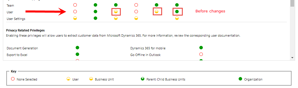

    My team encountered an issue where a person has been making changes to their own User record in D365.  They changed the First and Last name fields, email address, and some other fields as well.  This caused some major confusion as we saw two people with the same name when trying to assign a record.
    I made some changes to our Security Role to try to lock this down, but no luck.  Has anyone dealt with a similar issue?
    I changed the identified permissions to "None", but when tested the data in the User form can still be updated by a user who is not an administrator.  What am I missing?
    Thanks for any direction you can provide.
