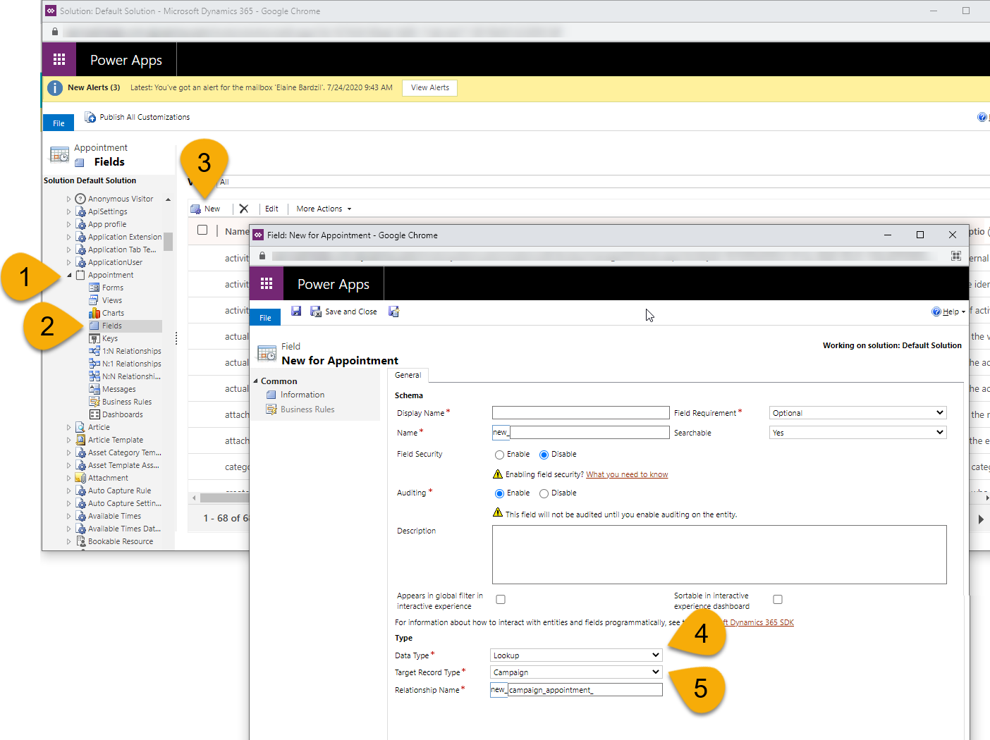

    We're looking into using Campaigns to better track how people are interacting with us. One issue I can't figure out is how to connect an Appointment to a Campaign. These are appointments (or tasks) we are putting in Outlook and tracking/set regarding into Dynamics. How do we show those appointments are from a particular campaign? I can figure out how to get contacts associated with campaigns, but not appointments. Ideas? Any ideas or insight is appreciated. Thank you!

    If I'm understanding your question correctly, you can create a new field in the Appointment table (entity) where the type = Lookup (4) and make the Campaign table your Target Record Type (5):
    Please let me know if I can help clarify any of the information above.

    Thank you! That's exactly what I needed to figure this out. I really appreciate your help.
