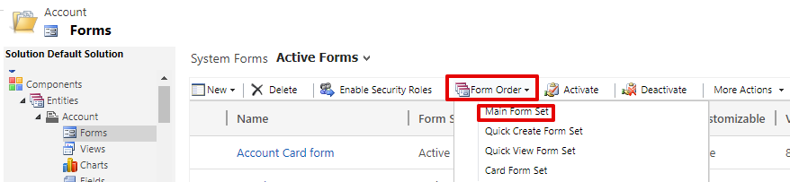

    @Tim Jarumbo - Hello! There are a couple of areas you may want to check. First, check the "Form Order" area to see if the form you want the users to use is at the top. Click on "Form Order" and then "Main Forms".
    In the "Form Order" window, select the form you need to use and move it to the top.
    Next, I would check the Form Security. Back in the list of all the Forms under the Entity, click on you form and then click "Enable Security Roles" next to "Form Order". Be sure the appropriate options are selected. Then, select the "old" form that you don't want the users to use and remove the security roles from this form.
    Lastly, be sure to Publish the updates.
