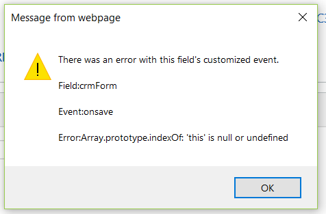

    Thanks for the help Andrew! I really appreciate it. Unfortunately, I am still getting the error message.
    There is another script on this form but only onsave not onload. Would it be helpful to look at that too?

    Posted Feb 28, 2019 12:27 PM
    Ok. Now I see it.
    Replace line
    _eligibleDiscountList = null;
    with line
    _eligibleDiscountList = [];
    Andrew Butenko

    The error seems to indicate the problem may be with browser support.  If you are using IE, have you tried opening CRM in a different browser such as Chrome or FireFox?  If it works in another browser, try adding this code to the very top of your script:
    // Production steps of ECMA-262, Edition 5, 15.4.4.14 // Reference: http://es5.github.io/#x15.4.4.14 if (!Array.prototype.indexOf) { Array.prototype.indexOf = function(searchElement, fromIndex) { var k; // 1. Let o be the result of calling ToObject passing // the this value as the argument. if (this == null) { throw new TypeError('"this" is null or not defined'); } var o = Object(this); // 2. Let lenValue be the result of calling the Get // internal method of o with the argument "length". // 3. Let len be ToUint32(lenValue). var len = o.length >>> 0; // 4. If len is 0, return -1. if (len === 0) { return -1; } // 5. If argument fromIndex was passed let n be // ToInteger(fromIndex); else let n be 0. var n = fromIndex | 0; // 6. If n >= len, return -1. if (n >= len) { return -1; } // 7. If n >= 0, then Let k be n. // 8. Else, n<0, Let k be len - abs(n). // If k is less than 0, then let k be 0. k = Math.max(n >= 0 ? n : len - Math.abs(n), 0); // 9. Repeat, while k < len while (k < len) { // a. Let Pk be ToString(k). // This is implicit for LHS operands of the in operator // b. Let kPresent be the result of calling the // HasProperty internal method of o with argument Pk. // This step can be combined with c // c. If kPresent is true, then // i. Let elementK be the result of calling the Get // internal method of o with the argument ToString(k). // ii. Let same be the result of applying the // Strict Equality Comparison Algorithm to // searchElement and elementK. // iii. If same is true, return k. if (k in o && o[k] === searchElement) { return k; } k++; } return -1; }; }

    Thanks Pheng! I'm getting the error in both IE and Chrome. There is another script on this form but only onsave not onload. Would it be helpful to look at that too?
    Here are two videos. In one video, I don't get any error message. In the second, I take the exact same steps but receive the error message. Do you know why it would behave differently from one minute to the next?

    My suggestion is to refactor the code and use es6, especially since you're on Crm365 v9.
    1.) You only need 1 "use strict"; and that goes to the top of the file
    2.) Stop using var, let and const are better suited and don't suffer from variable hoisting
    3.) Use the webApi and utilize OData. fetchXml is a pain.
    4.) Use literals. People don't realize that there is an actual computing cost when appending or "+" strings together.
    5.) Use forEach instead of for
    6.) Use falsy, same reason as point 4
    7.) Use a variable instead of constantly drilling down to the property from the object
    8.) Use async to prevent locks when getting data
    9.) Try to avoid functions within a function
    You can use jsHint and jsLint to check your code further.
    Ps. And I think I found your error using jshint
    Line 43: If a strict mode function is executed using function invocation, its 'this' value will be undefined.

    Jennifer
    Try removing all "use strict".
    Rex Kenley Tan, MCP
    Tallmadge OH
  • 17.  RE: Deprecated Java Script from Upgrade to Version 9.0
    Posted Mar 01, 2019 10:24 AM
    Hi Rex,
    I'm still getting the error message even though I've removed all the "use strict".
    Jenn

    Posted Mar 05, 2019 09:47 AM
    ​You can try using XrmToolbox.  Use the plugin called, "Dynamics 365 V9 JavaScript Validator"  When you run this plugin it will grab all of the java scripts, and then find the ones that have code that is deprecated and it will tell you what you need to do to replace the code.  I see that you are using Xrm.page in your script.  This code is deprecated in V9.  You need to replace that with ExecutionContext.getFormContext
    Hope that helps.
