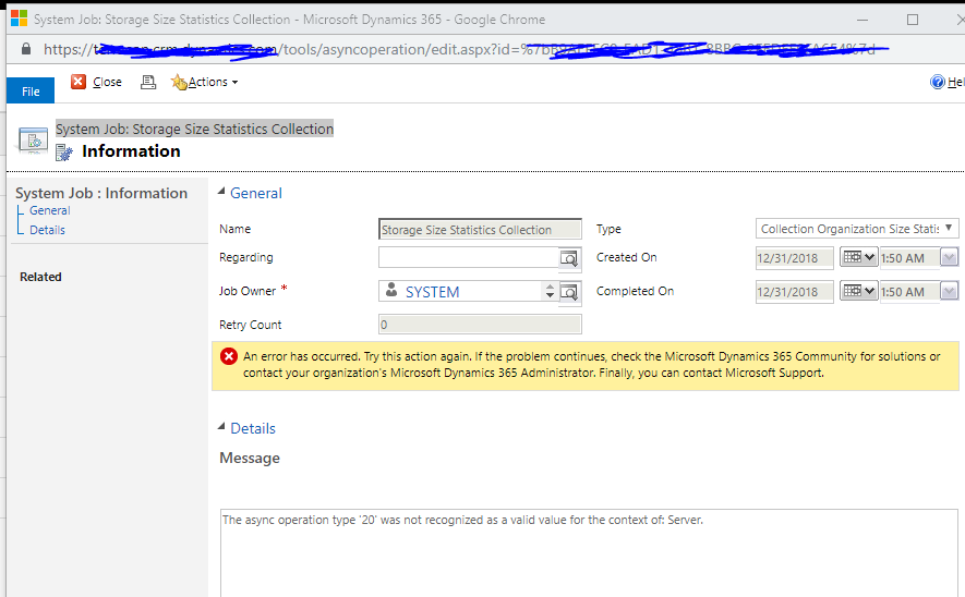

    This job seems to be failing every hour and I am not sure why.  Also, we have been deleting data from our sandbox and prod instances (to manage storage) and the storage space shown in the Power Platform Admin center has not changed to reflect the data we have removed - I assume this is related to this failing system job.  Any ideas?  thanks for your help!  Laura

    I'm seeing the same thing.  It looks like it started failing 12/14/2018 at 11:35 pm.  I don't see it running, succeeded or failed, prior to that.  I'm online, so I'm guessing they pushed out an update on 12/14.

    A little late to this but I just finally stumbled on this failed job myself (among other similar failing system jobs). In my searching it would seem that most v9 environments have this issue.
    There was another thread on the Dynamics 365 Community forum where someone posted MS support indicated this is a bug in v9 (the most recent reply).
