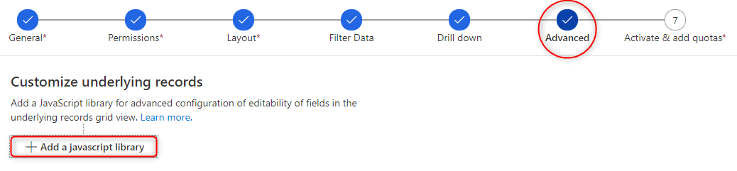

    Under advanced settings, when configuring a forecast, it is possible to ad JavaScript library for advanced configuration of editability of fields in the underlying records grid view.

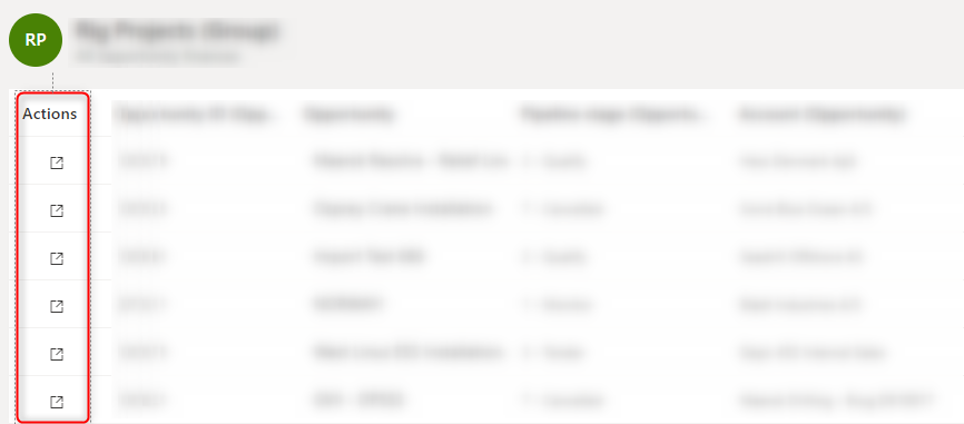

    In the underlying records view in a forecast, there is this great 'Navigate' button (please make this option available this for standard sub-grids, Microsoft), which will open the record in a modal/dialog (more here in @Jukka Niiranen's blog), so the user doesn't navigate away from the forecast.
    However, the issue in our case is, that we are not using the Opportunity entity as the rollup entity in the forecast - but instead a related entity named Opportunity finance. That means, that the user will open the Opportunity finance record when they click on the 'Navigate' icon in the underlying records grid view instead of the Opportunity records - which is the record it makes sense for the user to open and edit.
    So I am wondering, if it is possible, using JavaScript, to change which which record and entity the 'Navigate' button opens, e.g. based on another column in the view.
