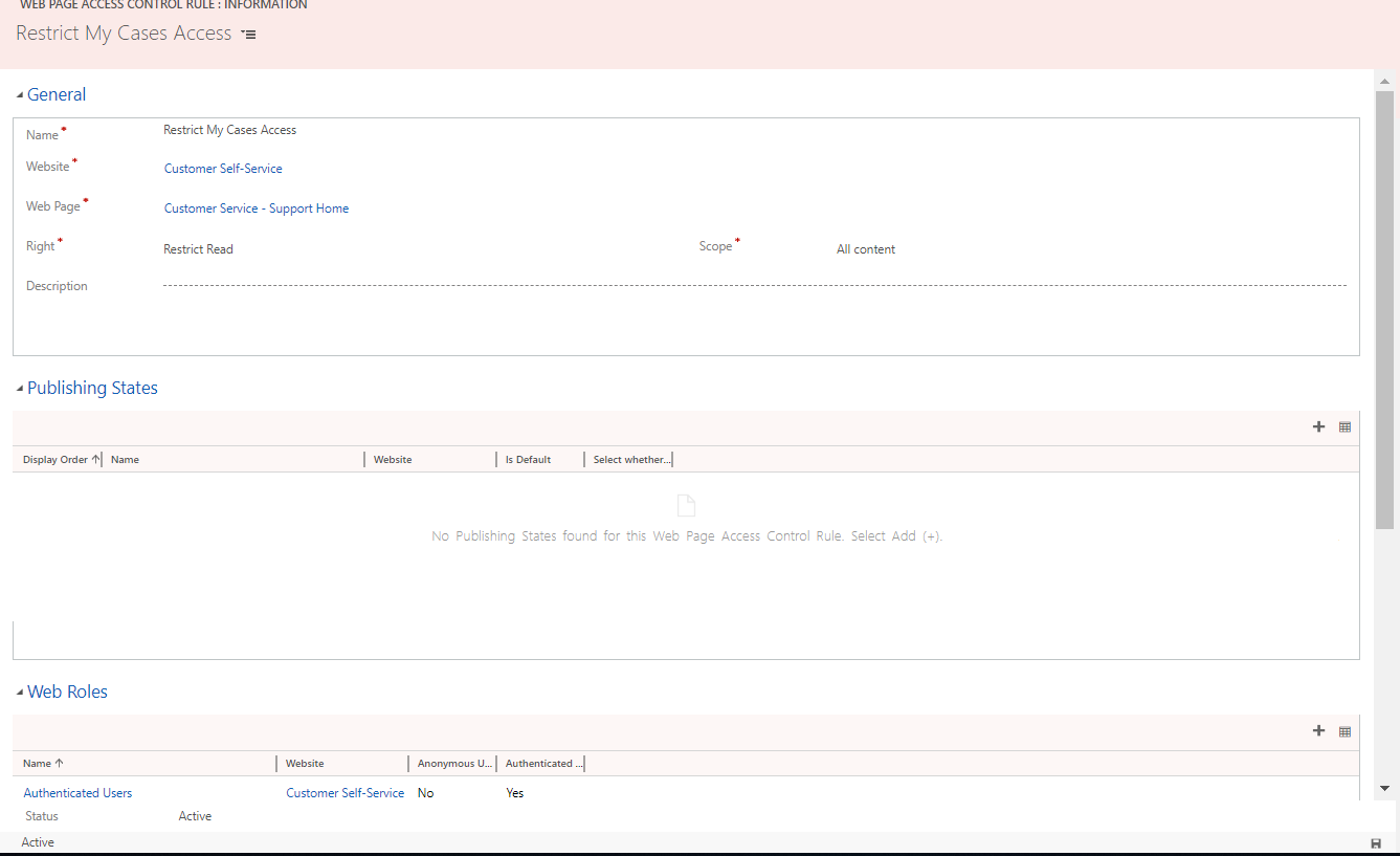

    ​I'm trying to hide an option from Anonymous Users from the primary navigation bar on out Dynamics Portal. The navigation bar currently looks like the screenshot below, and I only want authenticated users to be able to see My Cases
    My understanding is I have to create a Restrict Read rule  to that page(connected to the My Case link), and assign the Authenticated User web role, which I have done below. The problem is the link is still there on the navigation bar even after creating the rule. Is there something else I need to do to make this work?

    Hi Edrei,
    It definitely sounds like you're on the right track.  Perhaps it is a caching issue.  Have you tried clearing the cache?
    https://docs.microsoft.com/en-us/dynamics365/customer-engagement/portals/clear-server-side-cache
    (Although since it's been a couple days since you've posted, the cache should be invalidated by now anyways.)
    If it still doesn't work, let me know.

    @Nicholas Hayduk, it looks  like the cache invalidated and now the change is visible, thank you for the tip about  how to manually clear cache.
