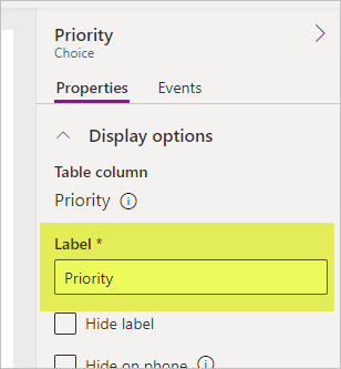

    Yeah, I'm not sure when, but column name changes stopped being reflected in forms a while ago.
    You just need to go into the form in question and update the label to what you want it to be.
