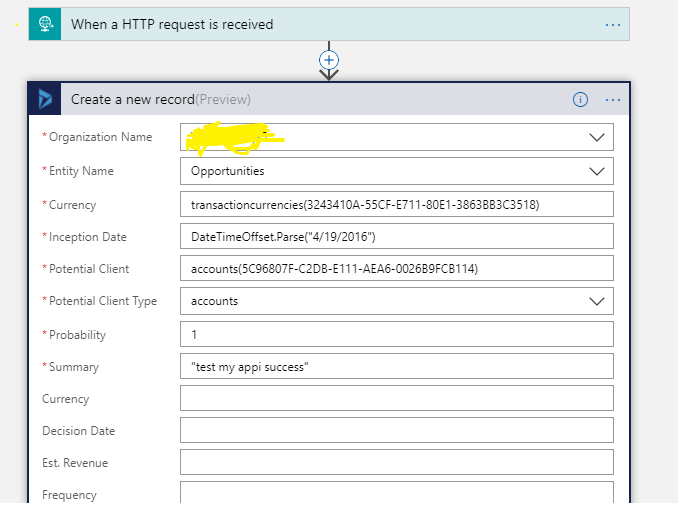

    Below is the screenshot of how I am entering the data in the fields
    screen
    still no luck . Need help on the same

    You've made it way too hard for yourself. All you need is the guids in the Currency/Potential Customer fields. The date needs to be in yyyy-mm-dd format. The below worked for me.
