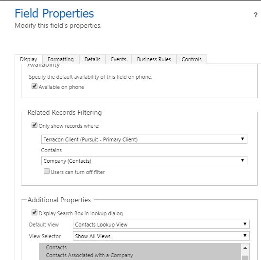

    Since we upgraded to V9.1, we have some functionality that is not working. On our opportunity, we list the related client and then the contact at that client/account.  We have set up a lookup field as shown below and it production, this is working correctly and the only contacts displayed are from the related company but in our sandbox which has been updated, we are able to search for a contact and all contacts that meet that criteria are displayed. Has anyone else experienced this issue?

    Yes!  We went to implement some related records filtering and noticed that it didn't work in a particular situation.
    1. Is in the Unified Interface
    2. Is on a quick create form
    We submitted a support request a few weeks ago and I suggest you do this as well.  The just got back to me today with the following response.

    @Travis Judd our issue is now resolved. We did not change anything, but it is now working correctly.  We had a call with MSFT today and they indicated that they had not pushed anything but I don't know how else it would have fixed itself?  Does yours seem to be resolved or is it still not working correctly?​
    thanks! Laura
  • 7.  RE: Related lookup not working after V9.1 upgrade
    Posted Nov 30, 2018 04:05 PM
    It still isn't working for us.
    Are we on the same version?
    It is only replicated in the unified interface quick create form.
    Let me know if you are on the next version.
  • 8.  RE: Related lookup not working after V9.1 upgrade
    Posted Nov 30, 2018 05:05 PM
    Yes, we are on the same version. We were having the issue in the normal interface.  i check the Unified Interface and we do not have an issue there either.​
