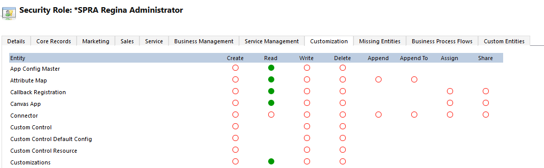

    I am trying to update a security role and noticed under Custom Entities the following:

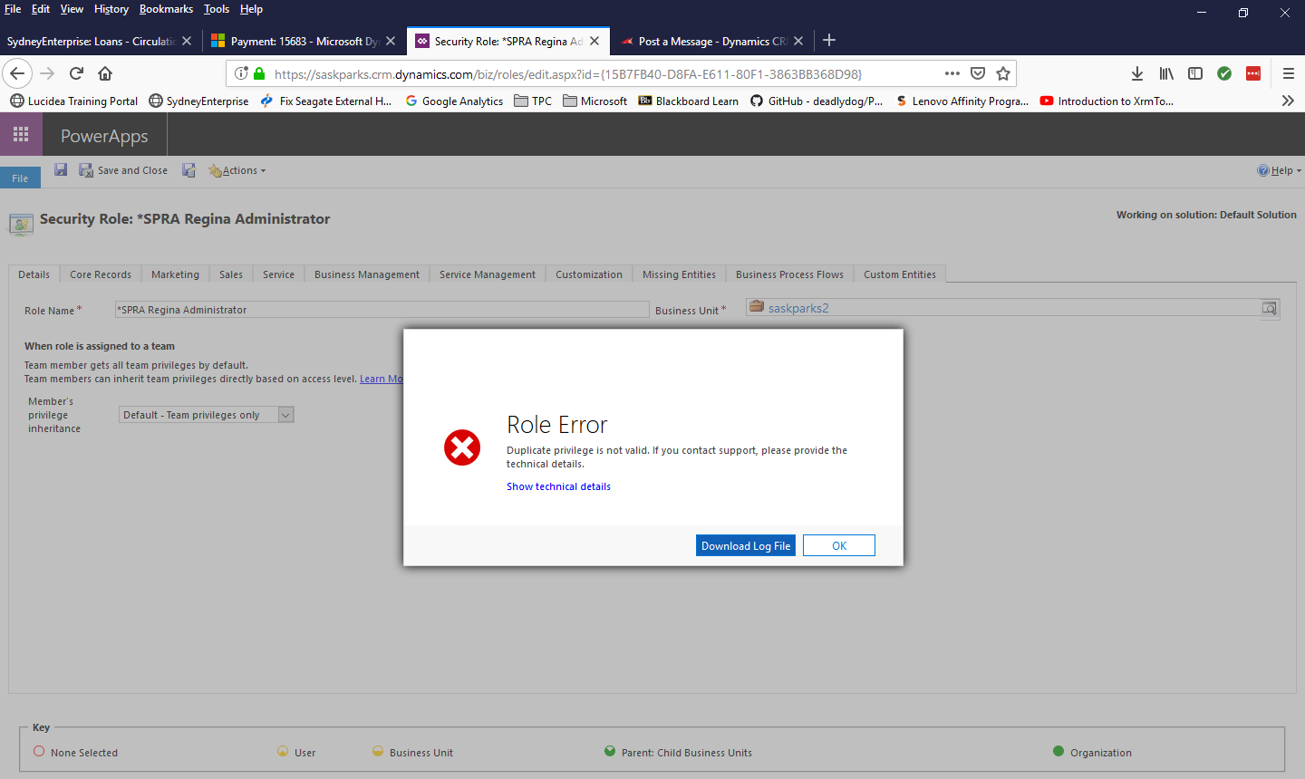

    When I go to Customization and try to assign any privileges to the Connector role, I get the following error.
    Any suggestions?

    Hi Ryan,
    What does the log file say? This is a very unusual error so I wonder what led to it. Have you moved this role around environments in a solution? Perhaps the entity didn't exist in an environment and became "orpahaned", or something similar.
    I wouldn't usually advocate this, but maybe it's worth exporting the role in a solution, and having a look at the XML. Look out for any inconsistency in the way the connector entity is displayed.

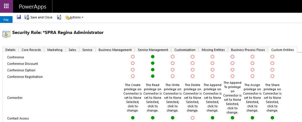

    @Ryan Monks - I am seeing the same layout in the security role as you are... words are displaying instead of the circles to toggle the security levels. I have a support request in with Microsoft to see what they say.

    Posted 16 days ago
    Not sure if MS got back to you Aaron but I am not longer see the text and it is back to the radio buttons.
