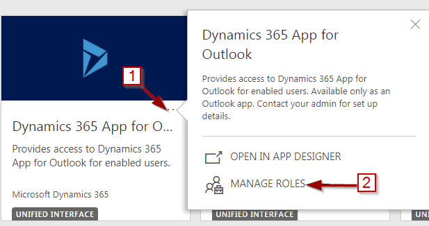

  • 4.  RE: Users unable to track email after upgrade to V9.1
    Posted Dec 03, 2018 10:32 AM
    Barbara,
    This applies if you are using the Dynamics 365 App for Outlook as opposed to Dynamics 365 for Outlook(the add-on).
    To apply the security roles
    1. Go to Setting -> System -> My Apps and you should be able to see Dynamics  365 for Outlook as one of the Apps.
    2. Select the ellipsis on the top right corner of the app and click on Manage roles and then select the roles you want to have access to the App
