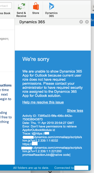

    We recently released the Dynamics 365 app for outlook to a few new users (a pilot testing group). Previously, only D365 system administrators had the app released to outlook and have been testing successfully for a few months. The new users have a salesperson security role. I have followed the deployment steps here but the pilot users are all receiving this error:
    Error Message
    We do not appear to have a unique security role called Dynamics 365 App for Outlook User that many forums and the Microsoft website reference but system admins are able to use the app without that role added to their user profile. Per the deployment instructions, I did verify that the salesperson security role had privileges enabled for the Dynamics app for outlook.
    confirmation that Salesperson Security role privileges are enabled
    Has anyone encountered this error and can guide me towards a solution?
