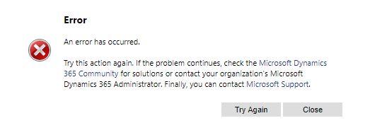

    An issue, however, appeared this morning.  Links that previously worked from Excel (or Word) are returning the following error message:
    If I copy/paste the link into the browser, it returns the proper entity record.  I looked at the security settings, but nothing jumps out.

    I was not aware of the different URL convention, but the issue still exists.  You brought up an important point though.  I am NOT encountering this issue in Power BI, Outlook (Office 365), or browser-based apps.  It only seems to appear when I make the jump from a local application (e.g., Excel, Word) to Dynamics.
    Also, Microsoft assessed the ticket and was able reproduce/confirm the issue.  They have escalated it to their development team.  Fingers crossed.
