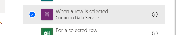

    The Flow equivalent to the On Demand workflow is the 'When a row is selected' trigger; however, this trigger is previous generation and is not solution aware.
    It's also a little flakey. To get it to work properly, don't change the name of the trigger, and add a get record after it to get the record that triggers the flow.
