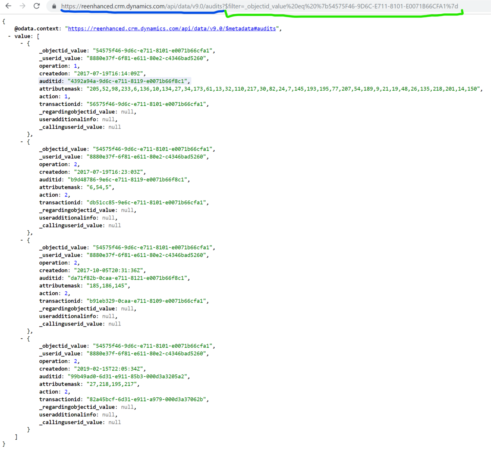

    The Web API is FUN!
    You can start to play around with the GET requests from right inside your browser:
    In the image above, the part of the URL I underlined in Blue is the Rest endpoint, in this case it's showing you Audit entities. The GREEN portion of the request is ODATA (See here: OData Version 4.0 Part 1: Protocol Plus Errata 02 ) that I'm using to filter the returned records to just a single object_id.
    The browser makes this request as a GET request and returns me the results so I can see them as JSON. (I'm using an extension called JSONViewer to make it easy to read.)
    With just a little bit of time you can start making your own Web API requests to figure out what your application needs to support.
    You won't be able to do POST requests or any of the actions, but this is good enough to get you started with understanding ODATA and actually see the data you'll get via Web API.
    Message me if you'd like more help, this is an area I'm very familiar with and one of the strongest tools in my toolbox. I've been writing web apps for nearly 20 years and this is so fun for me.
