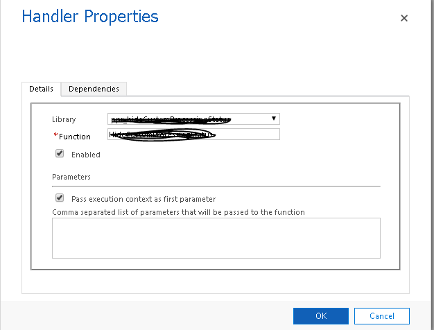

    9. If this is done on form load, then click 'Form Properties'.
    10. Edit the event handler, and ensure "Pass execution context as first parameter" is checked (set to true).
    11. Repeat this step for any field that calls this script.
    12. 'Save' and 'Publish' the form.

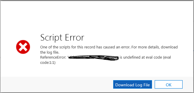

    ​After replacing Xrm.Page with executionContext() in webresources .js file I am getting below javascript error:
    Has anybody come across below error or know what is the cause of it?
    js error

    Posted Feb 22, 2019 01:17 PM
    This looks like you'll need to look at your log file and the source you modified in order to understand where the error is. Is there any way to share a redacted version of what you changed so we can help?

  • 22.  RE: How I updated Javascript resources from Xrm.Page. to ExecutionContext.getFormContext for D365 v9
    Posted Feb 22, 2019 01:24 PM
    It's not a direct replacement from Xrm.Page to executionContext(). You'll need to check to box to pass the context and then modify the function you're calling like this:
    FormOnLoad: function (executionContext) {
    var formContext = executionContext.getFormContext();
    Then, you can do things like:
    formContext.ui.tabs.get()
    formContext.getAttribute()
    formContext.getAttribute().getValue()

    ​I am doing all that below:
    function HideCustomProcessingStatus(executionContext) {
    // fetch all attributes on the form
    var formContext = executionContext.getFormContext();​
    var CustomProcessingStatusAttribute = formContext.getAttribute("xxxxxx");
    if (CustomProcessingStatusAttribute != null) {
    var privileges = CustomProcessingStatusAttribute.getUserPrivilege();
    if (privileges.canRead == false) {
    formContext.getControl("xxxxxx").setVisible(false);
    error

    Posted Feb 22, 2019 01:55 PM
    Jeebo
    Your code "looks" correct (although it could be optimize).
    What's getting my attention is the the error message "is undefined at eval code". It looks to me like Crm is not loading your js file properly. Try delete, add and then publish it again and see if that works.

    Posted Mar 07, 2019 11:48 AM
    ​Rex Kenley
    Based on your suggestion I have deleted web resource and added them back in the solution. Clicked Publish.
    But still form is throwing same JavaScript error. Any body faced similar issues when they changed the Xrm.Page to FormContext for CRM v9.1 in custom JavaScript.

  • 27.  RE: How I updated Javascript resources from Xrm.Page. to ExecutionContext.getFormContext for D365 v9
    Posted Mar 07, 2019 04:01 PM
    Rex Kenley
    I am getting error at 1st line in the function
    const formContext = executionContext.getFormContext();​
    line.
    it says invalid character.
    not sure the reason why?
    Regards
    Jeebo Mathews
    Agricorp
  • 28.  RE: How I updated Javascript resources from Xrm.Page. to ExecutionContext.getFormContext for D365 v9
    Posted Mar 29, 2019 10:17 AM
    ​Finally it turn out there was space after getFormContext() that was creating issues. Once I deleted the space everything working good.
