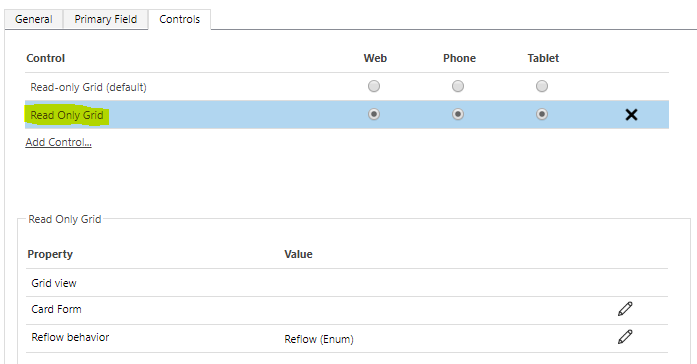

    I would like to use the Read Only Grid (the non-standard) as the default control for entity views in Unified Interface, as this control includes the filtering option for columns. So I have set this on entity level for Opportunities.

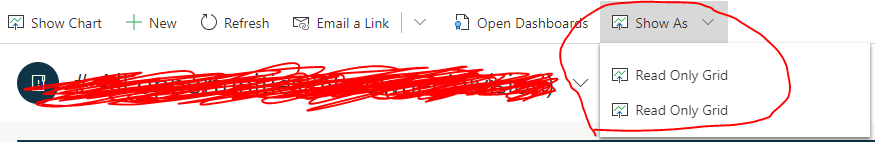

    However, the entity views are not displayed by default using this control. The user has to go and select 'Show as' and select the correct Read Only Grid from the list...
    Does anyone know if this is by design in Unified Interface? I really don't want to use the default Read-Only Grid and it is pain that the users have to change it each time they want to filter a view.
