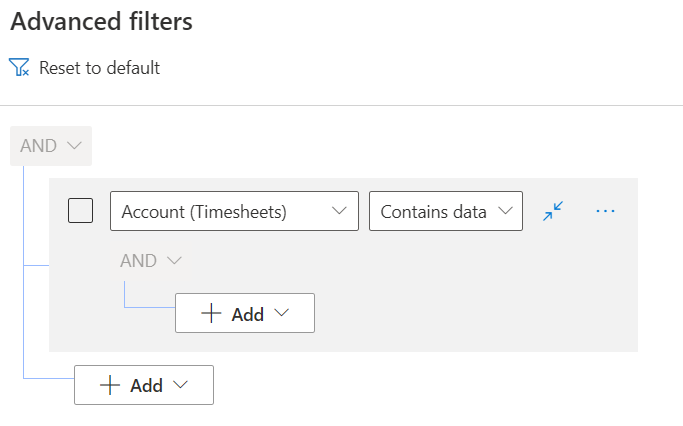

    Either create a view using Advanced Find (or in customizations) which filters on the related entity counting data or use the Filter near the search box
    eg - only list Accounts that have a Timesheet record against them for instance would be - in the add it is Related entity (you will find you will need to delete the filter that is auto added once you select the one you need (MS trying to help)
