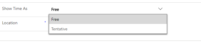

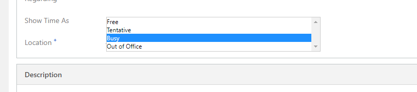

    We upgraded to version 9 recently , post the upgrade we found for the Appointment entity the statuscode option field shows only two values under UCI/UUI interface . imageOn the web it shows as below

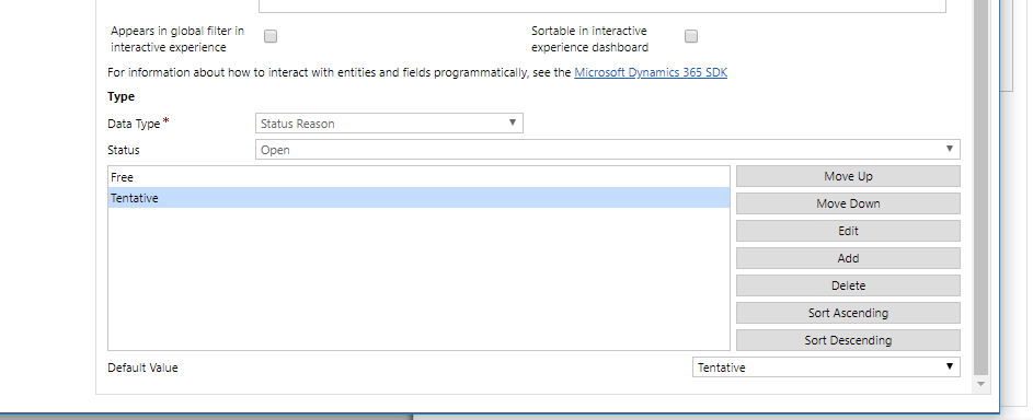

    i checked the form and somehow it seems that we have the status field locked out for Open option set
    status
    When i click on the status to check for close or any other option it does not change .. Anyone else noticing the same behavior ? to me it seems to be a possible MS bug.

    Microsoft was internally able to reproduce the issue they are currently discussing with their Dev team and have suggested that this will most likely be logged as Bug ..
    below is the response i received
    I was able to reproduce the issue in a vanilla org. Looks like this is a bug.
    Appears that there are only two options available in the status reason field in customization's – as it displays in UCI – not sure how/why 4 options are being displayed in legacy web view.
    I am discussing with our back-end team and will advise if it's a bug and when it will be resolved.
