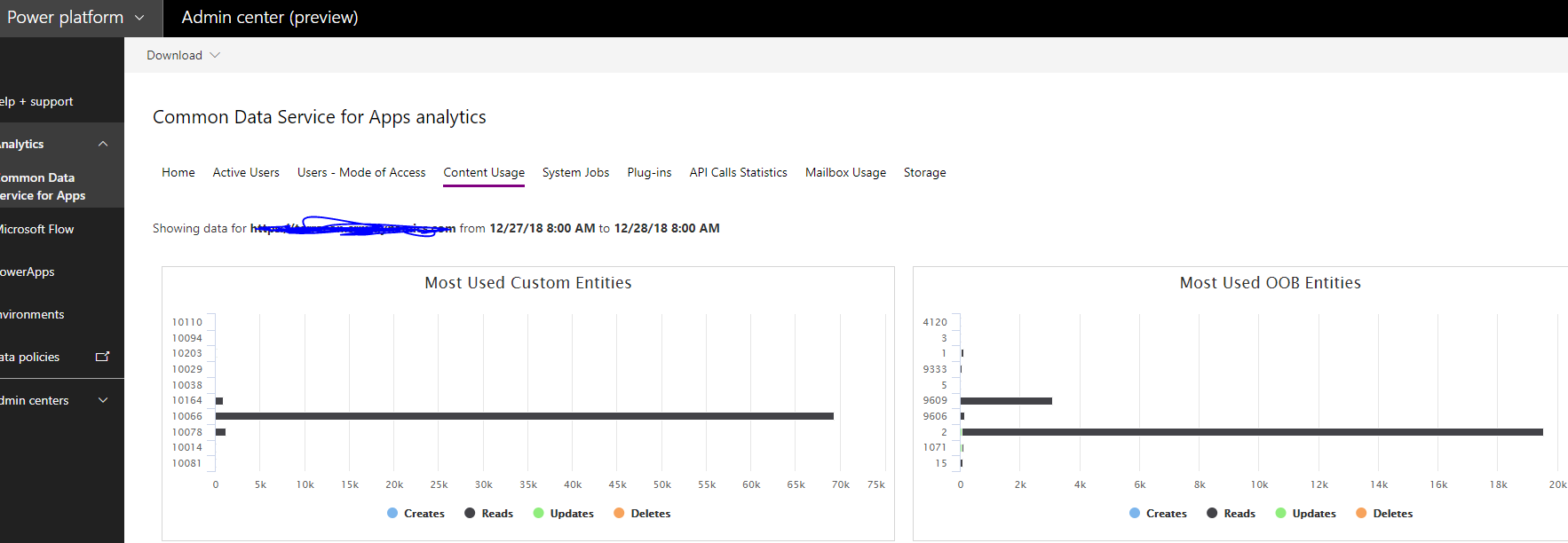

    ​How do i find a list of the OOB entity numbers? Also, how do i know the number for custom entities? Trying to make sense out of the new Admin center reports! Thank you! Laura

    ​I did find this, but i was hoping to get a list of all of our entities, rather than have to check one by one... Thanks! Laura

    You can use XrmToolbox and Metadata Browser plugin of it to get that data.

    ​That worked perfectly - thank you! :)

    You also could query the SQL database:
    SELECT distinct [Name],
    [ObjectTypeCode]
    FROM [yourCRMdatabase].MetadataSchema.Entity order by Name
