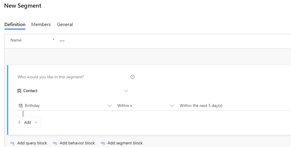

2a. Send email using the Marketing App
- Define a segment that Next Follow-Up Date is within the next x amount of time (e.g. Within the next month)
- A segment template exists for "Birthday within the next 5 days"; this is very similar
- Create a Customer Journey targeting this segment to send a Marketing Email
- Then trigger a workflow that sets the Last Follow-Up Date as the current date.
- Since Next Follow-Up Date is calculated, it will automatically update.

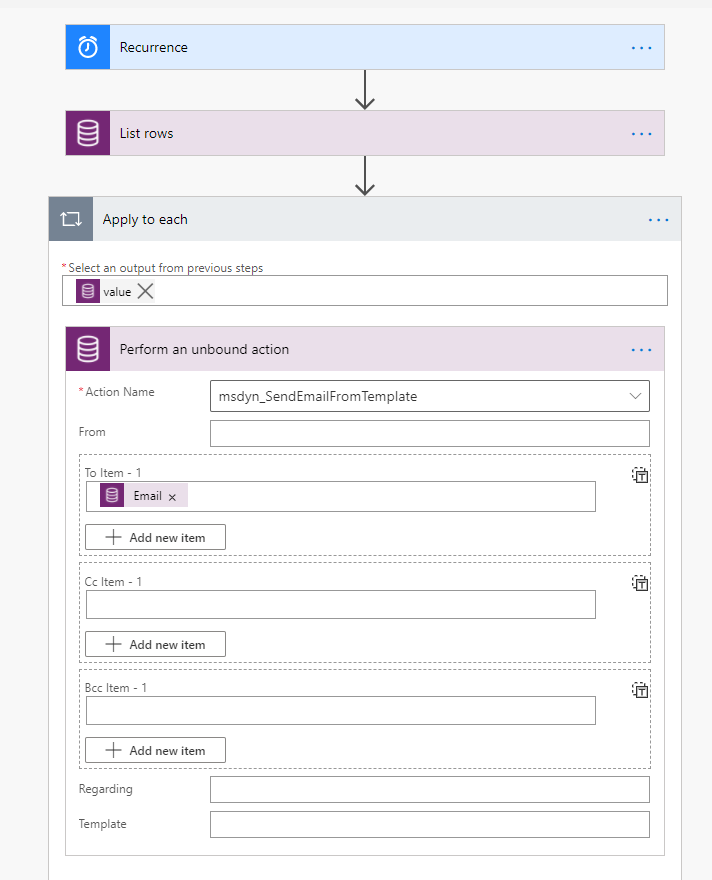

2b. Send email using Power Automate
Create a cloud flow in
Power Automate, which you have access to through any D365 license.
- Set trigger as a recurrence - e.g. every 1 week
- List Contact Rows where Next Follow-Up Date is within the next 7 days
- Apply to Each:
- Send an email using an unbound action such as "SendEmailFromTemplate" or "SendTemplate"
- To do this, you'll want to define an email template for contact communication, and this can reference dynamic content from the Contact row itself to personalize the email. This email will be a standard D365 email that has no licensing implications and is outside the scope of Marketing quotas.
Here's what the flow might look like:
