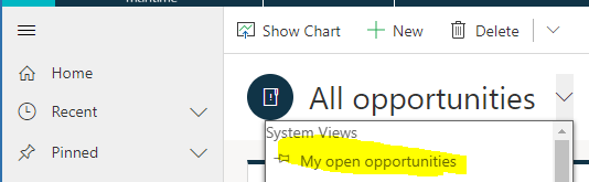

    Some of the views in my app are only used in sub-grids and on dashboards, so I do not want these to appear in the list of system views when clicking on a specific entity in the menu:

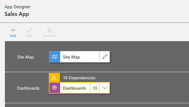

    When I run the validation feature in the App Designer, it tells me I need to add these views used in sub-grids and dashboard, as there are dependencies. However, if I do that all these views will now appear as system views - which is what I'm trying to avoid.

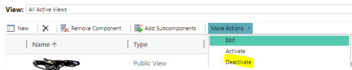

    I have tried using Solution Explorer and deactivating these views. That works - until you start making changes to forms or dashboards where the views are used. Then suddenly the users are not able to see the views any more and get an error message.
