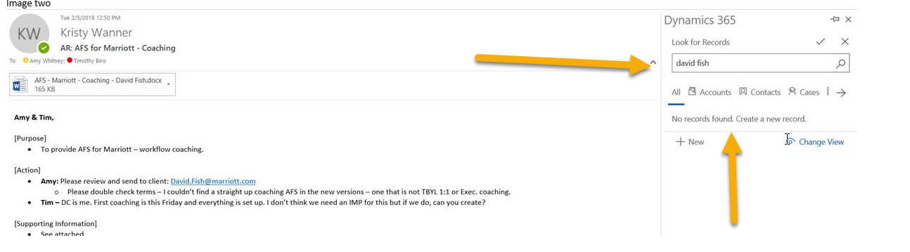

    We use the Outlook D365 Add-in, and have been successfully, for some time. We use this add-in to track and set regarding emails and appointments from Outlook to D365. Recently, a handful of our staff have experienced the inability to search for the contact using the add-in. A search returns "nothing found" even if the contact is in D365 already and we had previously tracked emails/appointments. Other users are able to search that contact and find them.
    I have re-added the add-in to their Outlook desktop with no success. Has anyone experienced this? Does anyone have information as to why this may be affecting certain users? Here is a snip of what it looks like after the search was executed. The contact, David Fish, DOES exist as an active contact in D365.

    Royann, I was having the same issue, and I found that Relevance Search was not enabled in my organization.  Look under Settings -> Administration -> System Settings -> and about 1/4 of the way down the page is the option you should check.   A screen shot is listed below.   Also, look at the Entities that are for Categorized Search and make sure your Contacts is selected there too.

    Royann-
      By your screenshot, it looks like you are using the Outlook App, not the Add-In.
      I encountered a similar issue recently, but am on version 9.2 of CRM.  (I highly recommend the update as it brings a lot of new features and functionality to the App!).  Anyway, this is the Microsoft instructions to clear the cache.  This worked for me, as it seems to be specific to the user, not the Admin settings.   However, I am not sure how often this may come back since it is a cache issue?
    1. Launch Outlook on your desktop and click on Dynamics 365 app from the Outlook ribbon on top.
    2. Go to File Explorer -> C drive -> Windows Folder -> System32 -> F12 -> IEChooser.exe
    3. Once you open IEChooser, you will find Click on Dynamics 365 thread
    4. Go to Network tab and click clear cache button on top.
    5. Try to perform search in Dynamics 365 App for Outlook after few minutes of clearing the cache.
    Hope this helps?

    Thanks to everyone and their suggestions. Clearing the cache using Ron's instructions was successful for all of our users having this challenge. Genuinely appreciate the assistance.
