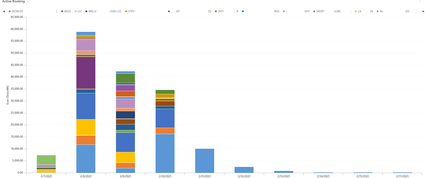

    Hi All,
    I have built this chart in dynamics:

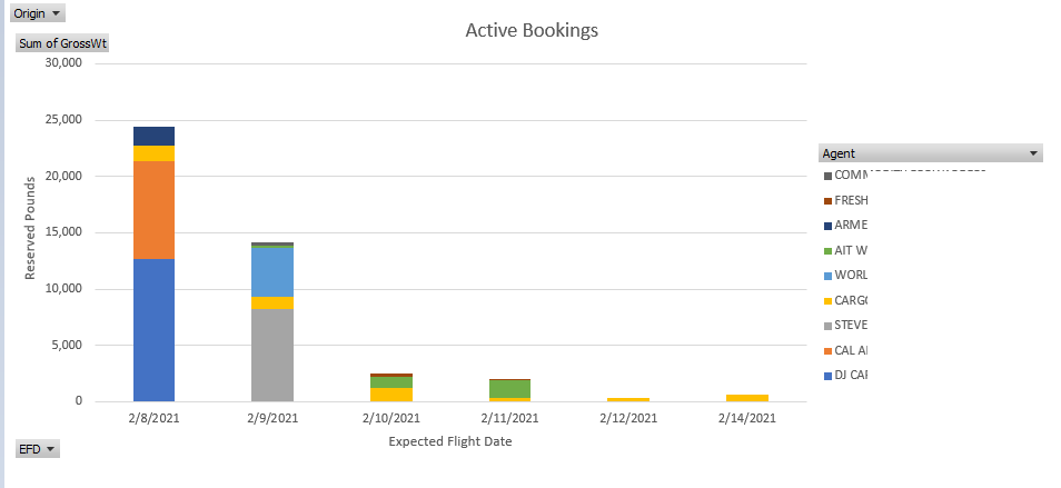

    But the problem is that the "Sum(GrossWt) is being ordered in the bar by Agent (alphabetical way) and I  would like to do it by GrossWt, see the example below in excel
    Is there any way that I can do this, I am using XrmToolBox with Advance Chart Editor to customize below you have the Chart Code in the attachment.
    Thank you in advance,
    Jose G Diaz

    Hello Jose,
    With weight being your aggregate I don't think that is something that can be sorted on. I believe the sort order only applies to your groupings which in your case are date and agent. @Ulrik Carlsson might be able to shed more light on this or correct me if I am wrong.​
