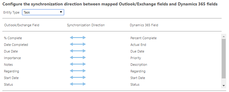

    There are a variety of settings that we've configured and tasks are successfully syncing from CRM to Outlook.  However we are having trouble syncing the other way.
    Our main use case is that we have mobile users that want to stop using Google Keep and start using Microsoft To-Do to keep track of their to do list.  Microsoft To-Do automatically syncs into their outlook, but we are having trouble getting the data to sync into CRM onto their dashboard.
    Notes on configuration:
    Tasks are successfully syncing out to Outlook.
    Just today we turned on this setting
    But after five hours we are not yet seeing Tasks come into CRM.
    Syncing is set to both ways
    Any suggestions before I put in a Microsoft Support request?

  • 5.  RE: Sync tasks from Outlook to CRM
    Posted Nov 28, 2018 11:08 AM
    Thanks everyone.  No tasks created in outlook are syncing to CRM.
    If a task was created in CRM and synced to outlook.  Changes to that task in outlook are syncing to CRM.  So I know the two way sync is working.
    Correct me if I'm wrong - but from what I'm understanding is that there is no out of the box functionality that allows tasks created in outlook to sync into CRM.
