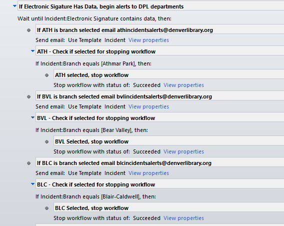

    Thank's to Aaron's email template help, I am now on the next part of my solution... emailing the masses. I have this working, but I am curious if I am doing this in the best way.
    The scenario - when Case / Incident is saved, email branch manger. We have 26 locations and an additional 30ish departments that will have to be part of this. People in branch 1, don't care about things that happen in branch 22 and so forth. My first iteration of this gave me 30+ emails on my first test. O_o
    So how I got this workflow going is this.... once the case has the electronic signature filed populated, email the proper location group. If the field Incident:Branch is populated with the required branch, stop workflow.  This does work - but am I making things harder on myself building it this way?  Is there a better way? If I have to add another 80+ steps I will but this seems crazy tedious. :)
    Workflow screen shot - is this the best way to do it?
    Thanks for any advice or links to resources to help me better understand this wild world of workflows. ;)

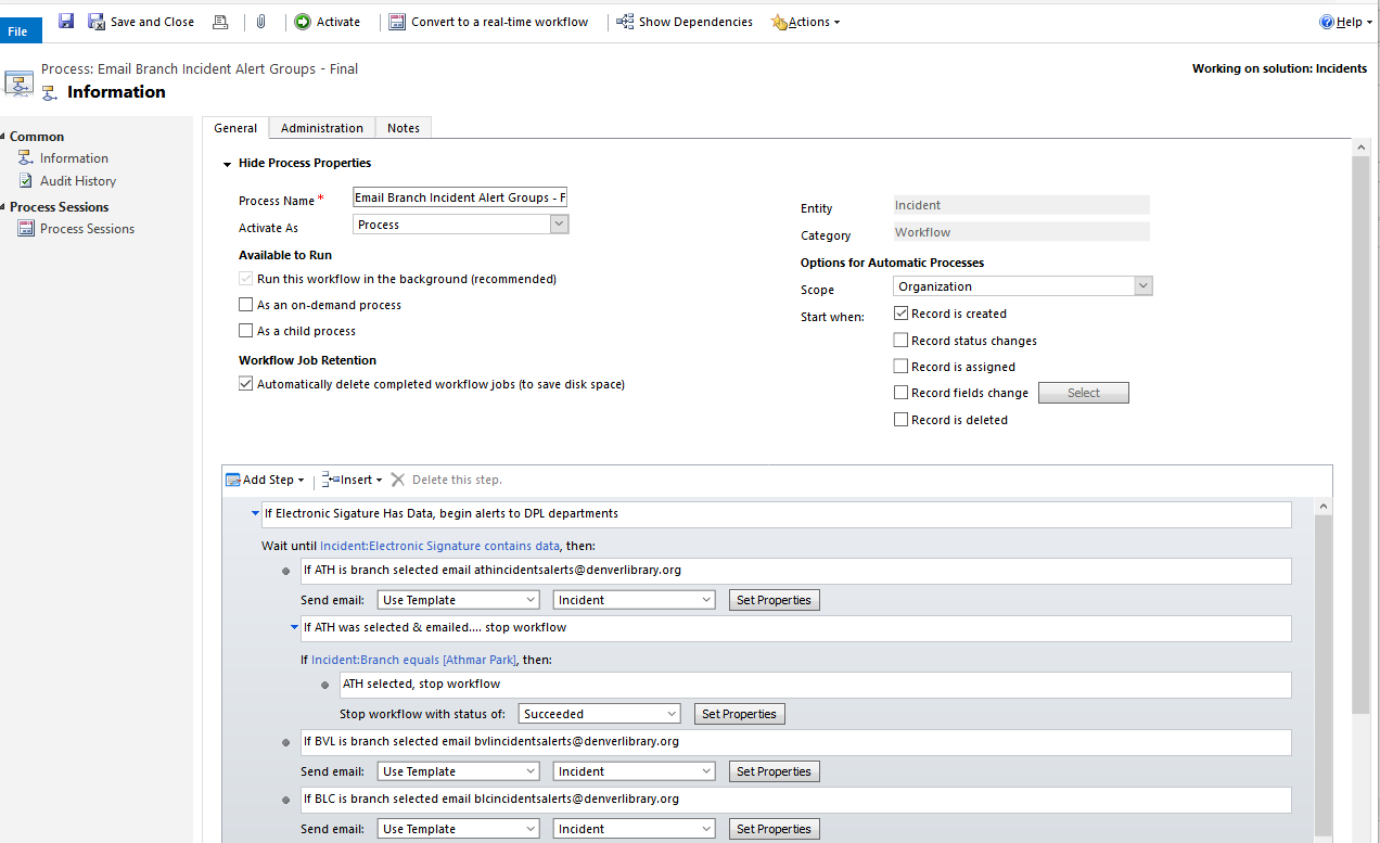

    ETA apparently I didn't "fix" this as well as I thought I had.
    Once the workflow advances to the next branch in line, the previous branches still get an email. So clearly I've not got this configured correctly - what am I missing?
    screen shot of workflow where multiple emails are happening

    Just a quick thought, why do you want the workflow to wait in the first step. This would mean, there are lots of workflows in the wait state. Rather than that, start the workflow when the field value changes.
    also, the other way is to have configuration entity, where you can define branch and the email template and write custom workflow step to trigger email.

    ​Regarding the logic and multiple emails getting sent - It looks like you need to review your If logic. Currently the email send is not in the If branch, so every email will be sent until it reaches the correct one.
    Current set up:
    Sent A email
    If A branch - stop workflow
    Send B email
    If B branch - Stop workflow
    Send C email …
    I would recommend
    If branch = A
         Send A email
         stop workflow
    else if branch = B
         send B email
         stop workflow
    else if branch = C
    If you use the "otherwise if" (else if, conditional branch) then you may not even need to include your stop workflows. As only one of the If branches will be called.
    I find in these type of scenarios it is very helpful to draw out what you are trying to do first. I usually use Visio. Then you can connect all the lines and line up the If/then statements to see how things actually line up.
    I agree with the other suggestions on the branch entity. This could allow you to pull that data from somewhere and hopefully streamline down to one email template that pulls data from that source instead of needing to have a different template per branch.
