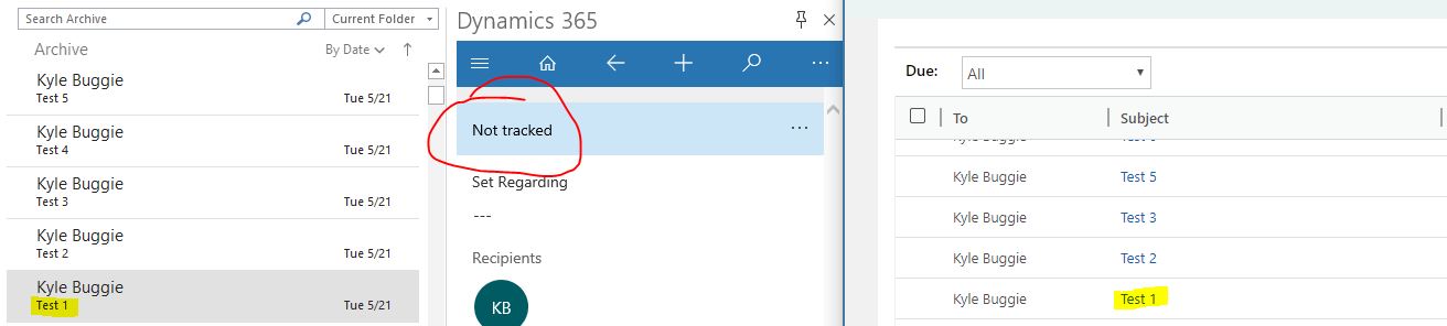

    I have a ticket in with Microsoft, but I wanted to see if the group had any insight into this issue.  My users are seeing inconsistencies in how email are tracked using the Outlook desktop client to Dynamics CRM (both in the cloud). There are two primary issues:
    • PERFORMANCE
      Users are experiencing extended delays after selecting the "Track without Regarding" option. This can take 10+ minutes (before receiving the confirmation) and appears to be more prevalent with sent emails.

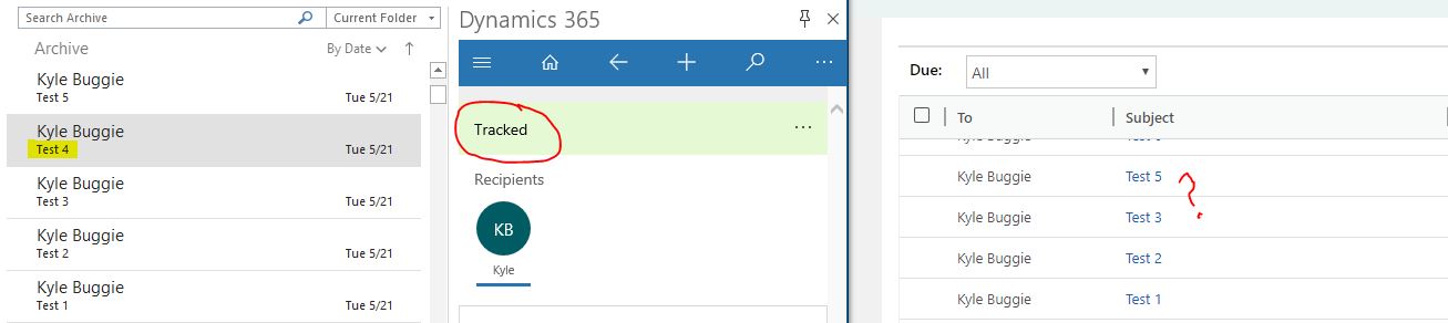

    • FALSE TRACKING STATUS
      After tracking emails, some indicate they are tracked and are not (and vice versa). I attached two images demonstrating this as well.
    This is, naturally, causing frustration and trust issues with our end users.  I could not find anything in the forum on the false-positives.  Has anyone encountered similar issues?

    @Kyle Buggie - On the false positives, have you clicked on the 3 dots in the D365 panel in Outlook on the green "Tracked" banner? From there you should be able to select a "View in Dynamics 365" option. This will help confirm fully the false positive. ​

    Good idea!  I followed the email through the tracked banner, and I found it is connected to an email in CRM-just not the right one.  My "Test 4" email in Outlook is actually linked to "Test 3" in Dynamics.  I am not sure how that happens, but wow.  I was performing some of these tests quickly (trying to replicate how a user might be rapidly tracking emails).  The dilemma is they cannot wait several minutes for it to process.
