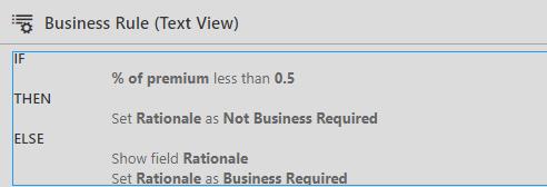

    I have 2 business rules that need to execute in a specific order.
    The first takes 2 fields, calculates a percentage value and is working ok.
    Calculates % value
    The second references the output from the 1st rule
    It does not trigger when '% of premium' is updated by the 1st rule, only when the record is saved.
    I tried changing the order in which the rules were activated but that doesn't seem to make a difference.
    Execution Order of Business Rules in Microsoft Dynamics CRM
    Both rules have scope set to "All Forms". All fields referenced in the rules are present on the form.
    Can anyone advise on the best way of setting 'Rationale' as Business Required based on the '% of premium' value, without having to save the record first and without using JS?
    Thanks in advance,
    Sean O Malley
    AIG

    Sean,
    I've encountered something similar before and it was very counter-intuitive.  You need to redesign your business rule to evaluate along a negative path criteria so you keep getting the conditions option.
    I've included a visual example of how this would look in the designer and how the logic should approximate in the tool.  You might end up with an infinite loop on clause #3, so I would check that, but this is the structure you would want to go for.
    IF
         Premium less than 0 OR Proposed Budget less than 0    (#1)
    THEN
         n/a  (#2)
    ELSE IF
         Premium greater than 0 AND Proposed Budget is greater than 0 AND % of premium is greater or equal 0.5  (#3)
    THEN
         Set % of premium to Proposed Budget * 100.00  (#4)
         Set % of premium to % of premium / Premium  (#5)
    ELSE IF
        Premium greater than 0 AND Proposed Budget is greater than 0 AND % of premium is less than 0.5  (#6)
    THEN
        Set Rationale as Not Business Required (#7)
    ELSE
        Show field Rationale (#8)
        Set Rationale as Business Required (#9)

    I created a rule following your steps (and put actions in Step2) and with a couple of additions it works fine on initial create of the record. But if any of the fields are updated,  the logic doesn't always work as planned.
    I've had to make these fields mandatory in all cases for now due to time constraints but I'll be reviewing again to see if I can get this logic working before releasing to Production.       ​​​
