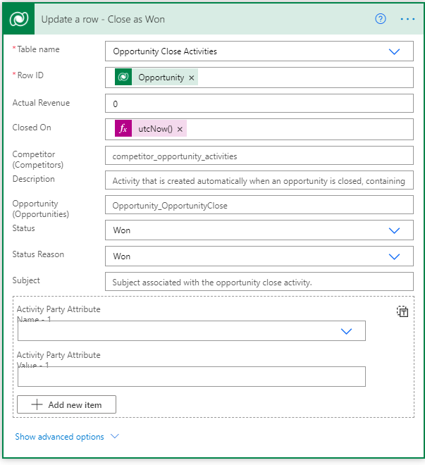

    I'm trying to use Power Automate to close opportunities that meet a specific condition, but when I get to the step that closes the opportunity, I get an error - 0x80040216 - An unexpected error has occurred. Status Code 400. I'm using the Microsoft Dataverse Connector - Update a Row with a table name of Opportunity Close Activities. Below is a screen shot of the step that is failing. Does anyone have any idea what my problem may be? I've researched and tried different things until I'm blue in the face. I would appreciate any help. Thanks.

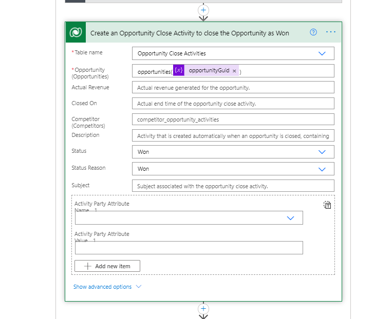

    I think that you are almost there. But instead of using the 'update' action, you need to use the 'Create' action. ​I've build a flow that's doing al lot of manipulating on a Business Process flow and the related Opportunity and in there I use the following action to close the Opportunity as Won. Hope this helps.

    Thank you so much Wim. That solved my problem and my Flow is working great now. I really appreciate your help!!
